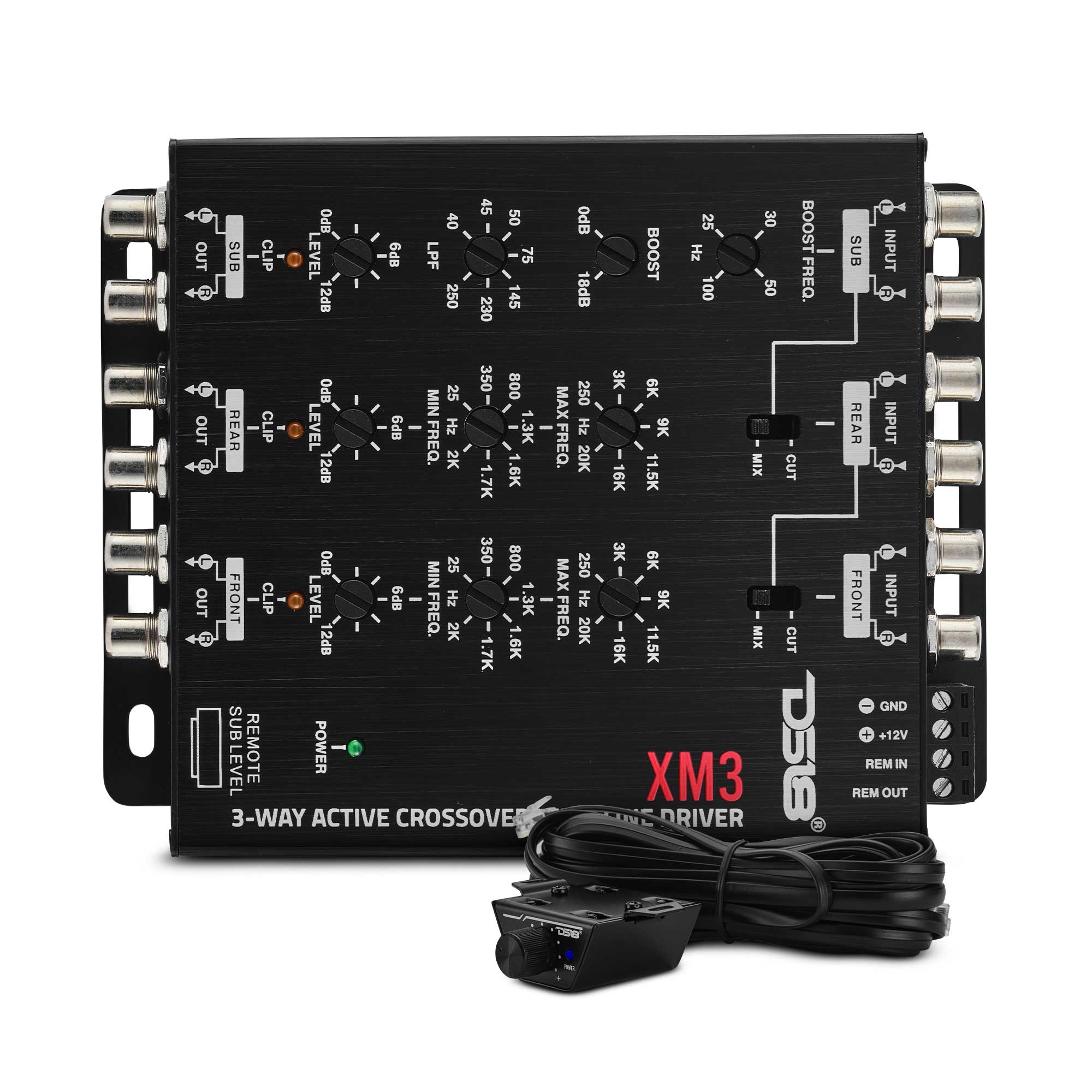

Or I will need to invest additionally into inexpensive non-DSP crossovers
finding that to be a rabbit hole in itself, especially featuring BPFs for the "basstand" MBMs
Currently researching
The latter is likely cleaner SQ I think?
Is that an "active" crossover? I love the idea of swapping those resistor network modules to adjust the crossover point rather than knobs that are likely to drift
"poor man's Marchand" ;-)
But I like the former's gain control, and the sub level remote may come in handy
maybe even adjustable bass boost?
I have built Marchand crossovers in the past. They are good for what they are but in today's prices, they cost way too much. I have also used Audio Control active crossovers. I prefer their 24 XS which is 24 dB/octave Linkwitz Riley and still has pluggable resistor networks to switch frequencies. I still have 2 of them on the shelf and am comtemplating using them again. I think absolute best bang for the buck right now is the Down 4 Sound EZDSP 68+. lt is based on the very good Analog Devices ADAU1452 DSP chip. I bought one of these over a year ago and have been very impressed with how it performs.
The owner of this business appears to have a lot of haters but the EZDSP processors he sells are good values with low noise and distortion. The processors are not quite as good as those from ARC Audio and Helix but they come close for a lot less $$$. Helix does make a DSP Mini which only has 6 channels I have seen priced as low as $399 used on Ebay but if that suits your needs, it is a great processor with the best software support in the industry. There are cheaper mobile DSP units under $200 but I have no experience with them. At the $200 price point, there is the Dayton Audio DSP-408. I own one of those also. It is a bit overpriced for what it offers. It used to sell for ~$150 before tariffs made everything go up in price. When you could get one for less than $150, it was a good deal.
All of these 12 Volt DSP units can be used in home environments with a suitable low noise supply. I would not recommend investing in an analog active crossover with the maturity of lower cost DSP units now.
