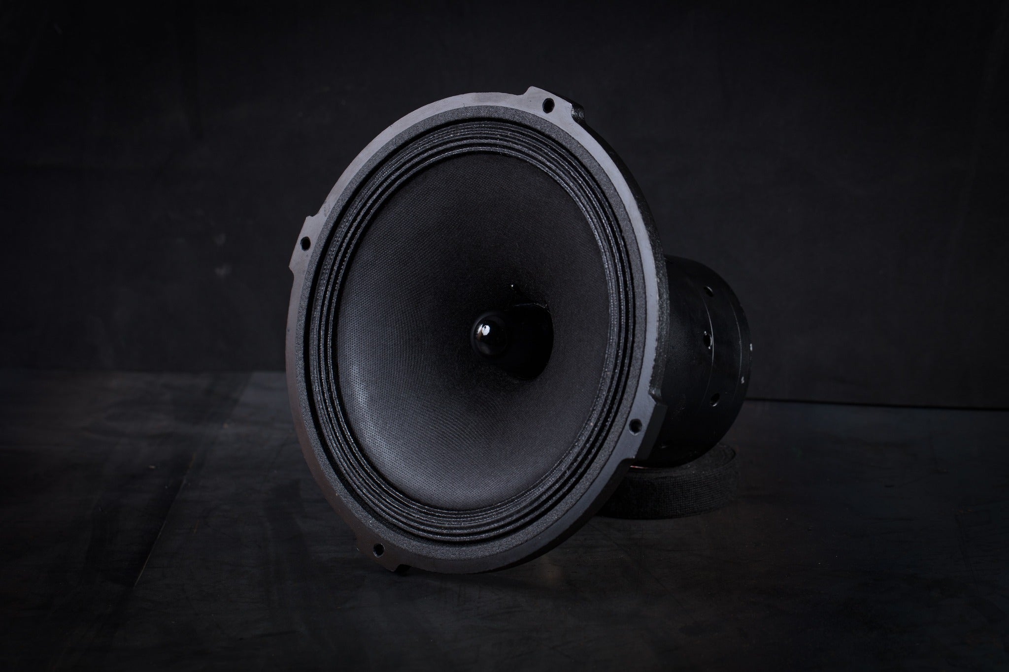

What's weird is all the fuss about the weight of the driver, as if it's enormous at 15 kilos.
A comparable size nice Audiotechnology 12" woofer for example is at around 10 kilos, so nothing too excessive about it.
At around the 9-minute mark in the video, Jones mentions 37 lbs for the drive unit alone. The 37 lbs, or about 17 kg, refer exclusively to the drive unit of a field coil driver in the Jones driver, not to the entire chassis. If you do the math, the realistic weight for the entire coaxial driver is more likely to be in the range of about 20 to 25 kg, or roughly 45 to 55 lbs.
Beryllium tweeters
The key factor is the stiffness-to-mass ratio.
Beryllium has an extremely high modulus of elasticity combined with very low density. This results in a very high speed of sound within the material, significantly higher than in aluminum or titanium. In practical terms, this means that a beryllium dome remains in so-called piston-shaped operation up to significantly higher frequencies before the first breakup modes occur. This breakup frequency is measurably higher than in most other metals.
That would only leave 50 kilos left for the rest of the two 12" (way lighter) drivers and the enclosure with some bracing, etc.
I would say, borderline doable for the size.
Field coils: as a guide to how heavy etc they are most commonly in terms of specs - fairly sure the largest manufacturer is Supravox. AJ’s new driver is a 10 inch. Supravox make one 11.4 inches - the 285, and 8.6 inches - the 215
Though the Supravox are full range rather than coax. a tweeter probably adds give or take 15% to the weight

The specifications on the product webpage for the Jones and Cerreta Troubadour currently show 5_Ohm nominal impedance and 95_dB SPL @ 2.83_Vrms @ 1_m voltage sensitivity, which translates to 82_dB @ 0_dBV (=1_Vrms) @ 1_m. In a video, Andrew Jones mentioned that the field coils on the tweeter and midrange will dissipate 50_W continuous in total while the DC bias power supply is energized. The associated heat is vented thru the bass reflex ports at the rear.
For comparison, the specifications on the product webpage for the MoFi Sourcepoint v10 Master Edition currently show 6_Ohm nominal impedance (4.5_Ohm minimum) and 91_dB SPL @ 2.83_Vrms @ 1_m voltage sensitivity, which translates to 82_dB @ 0_dBV (=1_Vrms) @ 1_m. That is 4_ dB less sensitive than the Troubadour, so the v10 requires 2.5x power from it's amplifier at the same SPL and propagation distance. But each Troubador dissipates that added 50_W while the field coils are energized.
