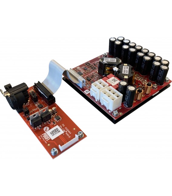

I like Purifi 1ET9040BA recommendation.

Purifi 1ET9040BA. Build yourself?:
or ready-made:
