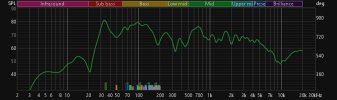

Yes, I've done measurements... dozens over the years, but only a few since I have the Kefs. I've attached two images from REW Audyssey: first without Audyssey, second with it. My mic is not the best for that, and levels are messed up between this two measurements but you just can ignore the level difference and look at the 'flatness' (or lack of) of the measurements.
Best,
Kurt.-

Since you are using a powered sub, a better amp probably isn't going to get you a noticeable improvement in sound quality. You do have some not-so-nice looking peaks in the bass even after Audyssey (35hz and 100hz) if you can somehow get those knocked down it would help. I find that peaks in the bass are really annoying.
You are also missing everything under 30hz, so if you are looking to spend some money on your system I'd suggest getting another sub and/or upgrading the subs to a pair of something beefier.
Upgrading to Dirac could also help, but room correction is not magic, it can only smooth out what the sub/room combination provides so much.
Lastly, it's usually possible to optimize the sound a bit by moving the speakers. But often that's not possible due to room / decor considerations.

The not-so-nice looking peaks I think are the resonances of my room. Time ago, there was a big dip around 70Hz that I was able to somehow fix moving the sub.
