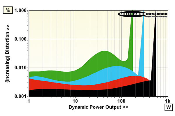

There are also some additional measurements with more detail on power and different loads from hifinews.com. It is one of the few staying stable as the power increases and load is changing (measurements are THD not THD+N but some calculations can be made). Bridge Mode was disappointing though. The website image of bridge mode is not correct. There is one hidden reflecting the officially published one (THD bridged mode). There is no free lunch as with bridge mode the load is getting in half increasing the noise and THD. There should be an option or done automatically to decrease gain. Maybe then could had better results. Still I have seen rare cases that bridge mode can work well on 4ohm let alone lower. I tried to compare stereo mode vs bridge mode on one of my speakers (Quad Revela 2) and I much proffered the stereo mode. In bridge was less clear, although there was a hint of more bass maybe as it was getting less controlled (increased harmonics). I was waiting a much more analytical review/measurements from soundstagehifi.com too. But they have published only for 9000Q leaving the promise for 9000P unfulfilled.
