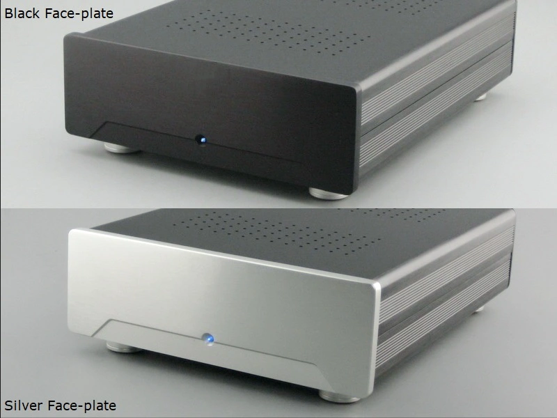

If you are into an easy DIY, an often overlook amp is the ICEpower 125ASX2, bridged BTL, especially now that is has been updated to Conductor tech.
2 x 242 usd each module + 135 usd Ghent case (XLR solderless) = 619 usd + shipping + customs
