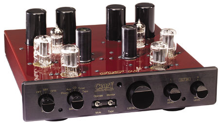

If it is an accurate copy of a Cary, then output impedance is 800 ohms. Not that I would trust that, but it could be so.
When Stereophile measured the SLP-98, it has an output impedance of 340 ohms (also spec'd by Cary as 800 ohms). However Cary used very small output coupling caps and that output impedance rose to 6800 ohms at 20 hz. Which will give a slightly rolled off and soft bass. Even more so with a low input impedance class D amp. Still if the OP wants to give it a try it isn't a ton of money. Who knows if it is an accurate copy or not.
