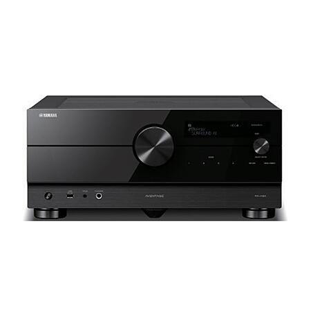

One thing that I also like is that Yamaha A8A
It doesn’t have Dirac, so full range correction is limited (it does have a PEQ), but since you are running a speaker that is anechoically flat, you may benefit from the virtual surround features when playing music. You can also use cheap wireless surrounds if you like. (MusicCast rear).
Its on sale now for $1600. AudioVision.De had the stereo performance at 260W.
