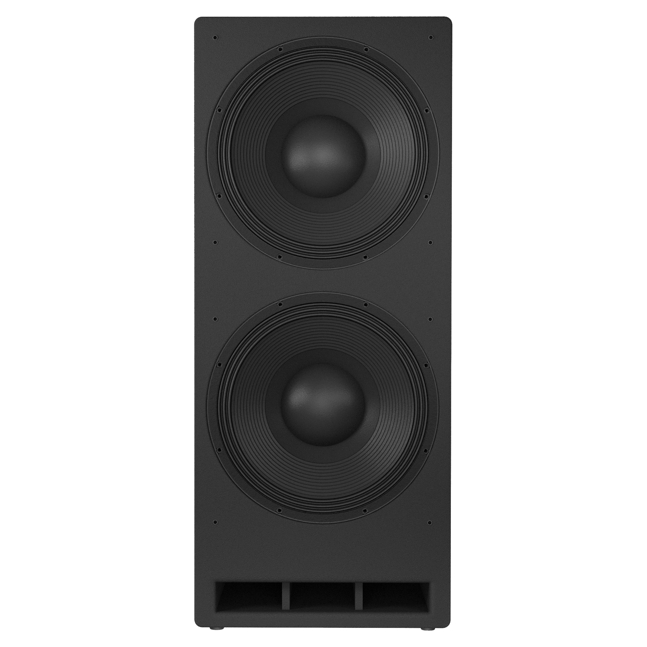

Regardless of which option you pick, 2 subwoofers should be considered the bare minimum, 4 is ideal. You get higher peak output and better bass quality this way. The bass management in modern AV processors scales with subwoofer count.

For subwoofers, I don’t think the current Genelec or Meyer Cinema lines are designed to hit the true subsonic response that makes home theater fun.
Hobbyist level subs like this are great options
