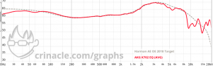

Somehow this sounds overly dark and muddied on my K702. Both your and oratory1990's measurements suggest a peak at around ~5.4kHz, but from my subjective experience and crinacle's measurement, the peak does not exist. When I apply filters at around 5kHz, the detail is lost by a significant margin, and the overall tonality sounds suffocated. There is indeed a peak at around ~2.3kHz which can be solved via EQ.
Below is my EQ profile and I am confident that the tonality will be more neutral than the configuration above. The profile is a mixture of crinacle's (band 1-4, which result in a better bass extension for me) and oratory1990's filters.
Code:
Preamp: -6.3 dB
Filter 1: ON PK Fc 60 Hz Gain 0.6 dB Q 4.570
Filter 2: ON PK Fc 76 Hz Gain -0.6 dB Q 3.760
Filter 3: ON PK Fc 97 Hz Gain -2.7 dB Q 0.490
Filter 4: ON LSC Fc 105 Hz Gain 6.7 dB Q 0.710
Filter 5: OFF PK Fc 210 Hz Gain -1.0 dB Q 0.600
Filter 6: ON PK Fc 760 Hz Gain 2.2 dB Q 1.500
Filter 7: ON PK Fc 1020 Hz Gain -1.1 dB Q 3.500
Filter 8: ON PK Fc 2300 Hz Gain -3.6 dB Q 1.900
Filter 9: ON PK Fc 2650 Hz Gain -1.0 dB Q 5.000
Filter 10: ON PK Fc 3500 Hz Gain 1.0 dB Q 1.400
Filter 11: ON HSC Fc 12000 Hz Gain -1.0 dB Q 0.710
Note: band 5 is OFF by default but you can adjust it to your preference in warmth/muddiness.
Below is the FR before/after EQ. It uses crinacle's measurement but I don't find it deviating from oratory1990's except at the 5kHz area.
I might do some experimentation sometime to see if I really do have a peak at 5.5kHz. Given that I actually measured my various K702 units on the miniDSP EARS using a specific conversion curve, which is based on the fact that Oratory measured one of my units and me measuring that same unit on the miniDSP EARS, so I'm confident that if Oratory's measurement is good then all my 4 K702 units have that peak at 5.5kHz according to GRAS. But I may do some experimentation through sine tone listening to see if I can also identify any peak at 5.5kHz. It is interesting that Crincacle's measurements don't show the 5.5kHz peak (I've been aware of that for a while).
I don't really think you can make the following statement that you made: "Below is my EQ profile and I am confident that the tonality will be more neutral than the configuration above". I don't think you can know that. It's possible it might be better for the unit of K702 that you have, but I know for my 4 units of K702 that Oratory's latest EQ's are way too bright - I described in my original post at the start of this thread that his measurement has gotten darker overtime in contrast to his earlier K702 publications - so a darker measurement means a brighter resultant EQ, his EQ's have become brighter overtime for the K702 and it's way off when used on my 4 units. But you know, people can try Oratory's EQ, they can try EQ's based on Crinacle's measurement, they can try my EQ based on my measurements of my own 4 units which I offer in this thread - so I don't mind what people use, it's good that there are some rational choices out there that people can select from.
Hi, an update on this, I took my Unit #4 and listened to some slow sine tone sweeps, and there is indeed a large peak for me at 5000Hz, and there was one at 7000Hz too, and they were really the only ones I noticed when doing it with my eyes closed so I couldn't see what the frequency was (to prevent bias). I don't think I really detected the one at 2500Hz, but that's probably because my Unit #4 has a slow roll off of the frequency after 2500Hz so probably not that detectable, whereas the peak at 5000Hz is an abrupt change (note that the faint line in the following graph is my average of 4 units of K702 measurement without EQ - you can see the peak at 5000Hz):
index.php
So I'm confident that the Oratory measurements are a closer fit for my headphones than the Crinacle measurements, as Crinacle doesn't show a peak at 5000Hz, yet I've clearly heard the peak during sine sweeps. (Interesting that the peak at 7000Hz that I heard is not shown in the measurements of my Unit#4, and I certainly didn't used to have a natural peak in my hearing at 7000Hz when I've listened to slow sine sweeps on anechoic flat speakers....so I'd say the 7000Hz peak that I heard is also a real thing in these headphones when I wear them).
