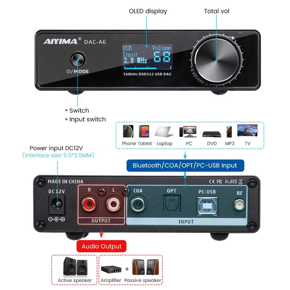

This is a review and detailed measurements of the AIYIMA DAC-A6 stereo USB DAC plus Bluetooth input and volume control. It was sent to me by the company and costs US $186.
The A6 has one of the better implementations of display/UI than most DACs:
It is also quite responsive to volume control input. Inclusion of volume control means you can directly power a studio monitor speaker or power amplifier without the need for a preamplifier. Note however that there is no remote control so it is for desktop use mostly.
Back panel has the usual inputs and outputs:
Note that the power supply has a blue LED which is nice in telling you it is plugged in. But may be annoying to some. Bit of tape may be useful for people in that camp.

Don’t like the OLED display and the mirror look face plate looks cheap.

What's to dislike about the OLED display? Some disadvantage?
Showing a static image they will not last very long.
With daily usage for example on the PC maybe 1-2 years before significant "burn in"
They tend to suffer from burn in with static text and images.
JSmith
In this price range, you might as well throw it away when screen deteriorates.
Don’t most of these DACs have oled displays? Topping has oled, right?
So many dacs in the same segment nowadays; worth scratching one's head.
Which is good, because you can more easily find one that has the features or looks you want.
No remote control is a bit of a letdown IMHO.
Strange choice indeed, In 2021 especially since it doesn't have a headphone output which would imply desktop use, but here you even have BT in so you can stream from a distance but you have to walk to the thing to switch inputs, SPDIF does not really have a use on a desktop setting neither. That's just poor product definition, if you want to make a desktop only product, put a headphone amp and put USB only.
