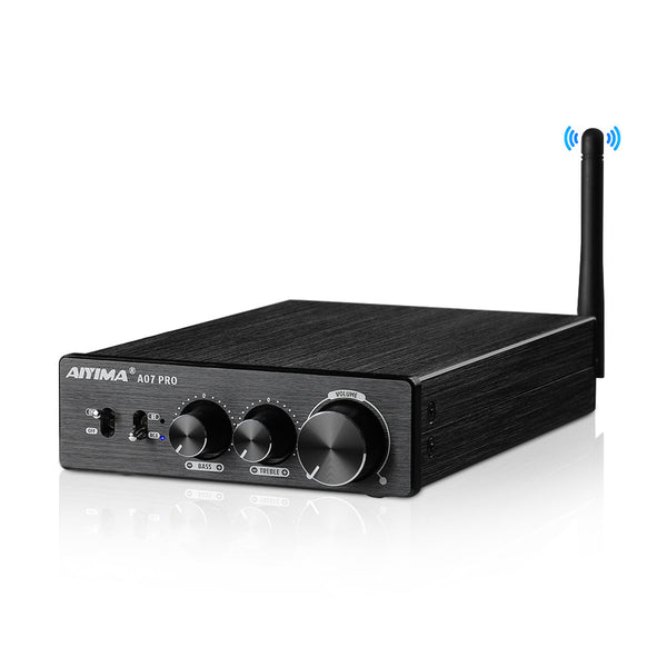

Just as the title says...
A07 PRO TPA3255 Bluetooth Power Amplifier
Chipset: TPA3255+NE5532+QCC304X
Bluetooth: Version 5.2 Bluetooth support: 16-24bit 44.1-48khz Supported format: sbc/aac/aptx/aptx-ll/aptx-hd
Replaceable OP amp chips: SR3609SM, OPA2604, OPA2314, LM4562, JRC5532, OP275GSZ, OPA1612AIDR, etc.
Distortion: 0.002%
Signal-to-noise ratio: 90dB
Frequency response: bass ±12dB; treble±10dB
Input sensitivity: 0.84vRms
Speaker impedance: 4-8Ω
Output power: 300W*2/4 Ohm
Input mode: Bluetooth, RCA
Support audio input devices: mobile phones, MP3, computers, CDs, decoders, audio preamps, etc.
Output mode: 2.0 passive speaker + AUX
LINE OUT: Connect the power amplifier or active subwoofer
Working power supply: DC24-48V, 5A or more
Packing size: 168*114*32MM

Yuck, now they're raping the poor amp with bass and treble controls.
Do you already have a picture of the circuit board?

Well... If you all send me a couple of bucks.. Not begging.. I would buy it, order it tomorrow in fact... tear it down... Get some pics going and then send it to Amir.
I agree with Roland here... I am not a fan of the tone controls, but, in and of itself it isn't a bad thing overall. If it keeps it clean. The lack of LDAC is a bit sad.
The big plus I see though is the "higher quality" caps... The new inductors and the 4 upgradeable op-amp slots. Although these sockets do look a bit close. So for those fans of larger discrete op-amps... This might be an issue. IC op-amp rolling won't be an issue though.

I have purchased this new A07 pro... I will contact @amirm and see if he wants to measure it. I will open the device and provide the community with pictures of the board. I am looking forward to see what improvements are there. Thanks for responding to the post.

300 Watts per channel. I have seen this claim. Please explain under what conditions this amp produces this power.
Hi! According to the situation where you want to achieve 300W output power, it is recommended that you make the following changes: 1. Remove the case and increase the heat sink.
2. Add a heat exhaust fan to reduce the heat generated by the chip.
3. Try a 50V12V switching power supply, and the output can reach 300W under the condition of 10% distortion. The existing A07 and A07PRO of TPA3255 can use 48V10A power board, 4ohm 240W*2 distortion 10%.
Including all TPA3255 chips on the market, they cannot reach 300w*2. But we have designed the maximum optimal power. At present, we have developed a more suitable 36V6A power supply, which can reach 6ohm/100w.
