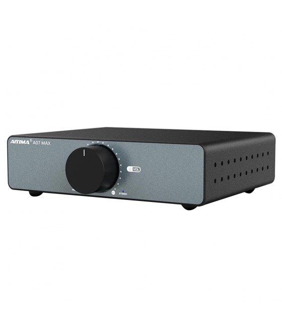

I believe that when we attach the sensor to the case, we can observe a higher temperature. As I mentioned earlier, the sensor was placed between the amplifier case and the table, and it measured the air temperature between the table and the amplifier case. When I tried to touch it with my hand, it felt hotter than 42°C.
@Toku has clarified this already nicely, but I would also pitch in without disagreeing with anyone or anything you all are observing.
Why would you think the amplifier chassis getting a bit hotter is an issue while it is designed to do so.
Amplifier chassis is super compact and doesn’t use bigger heatsink. It uses chassis for heat management.
This is expected behavior, unless it really gets hot to problematic levels (like 50-60 degrees plus).
Bigger yamaha (I have one), Sony and other integrated amplifiers get hotter even though they use bigger chassis and heatsinks.
I have recently added Topping PA7 to my desk, which uses 48v 5a psu, and it gets hotter than A07 max with 48v psu.
Both A07 Max and PA7, with 48v 5a psu, use 8 - 14w (7-8w for A07 max, 13-14w for PA7) at idle and remains there when playing upto certain spl levels.
If someone decides to go for A07 Max with 48v psu, ideally you should use 40v or less, then should expect it to run a bit hotter. Using a riser to make up some space between amplifier chassis bottom and stand/table helps (Just physics).
@guddu I tried using it, but unfortunately, it did not help with the cooling. I am now considering the possibility that if the amplifier chassis were bigger, it might have a positive effect on cooling. Perhaps I made a mistake somewhere along the line, as I have another amplifier that does not get hot and I believe that class D amplifiers are not supposed to get too hot either.
Perhaps this one isn’t best fit for you, but you should try 36v 6a psu with it as you already have the amplifier. You may not even need to go with 48v psu if your pre-amp/DAC is goo enough to output around 2v.

Shouldnt the A07 Max get as hot with the 36V supply as with the 48V supply if you set them both to the same volume?
Разве A07 Max не должен нагреваться так же сильно при питании 36 В, как и при питании 48 В, если вы установите для них одинаковую громкость?
Тoday i try 32V PSU, the volume level the same, no difference, only low frequencies is a better on 48 PSU.
