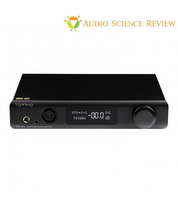

Hello, first of all I am French so sorry for the translation.
I have a sennheiser hd-800s paired with a topping dx7 pro.
By reading this article I understood with astonishment that the Toppings are really bad on the HD 800S. And it saddens me at the price I paid for it.
I wanted to try another headphone amp. Do you have any recommendations for me.
The sennheiser hdvd 800 is the best seen that it is the same brand?
I have a budget of 1000 euros. Thank you for your help.

Your Topping amp is perfectly fine - I wouldn’t give much credence to the article you linked. The most important thing is to figure out a way to EQ your headphones since the HD800S has some frequency response issues that need to be corrected. Depending upon your source, you can do this in either software or hardware. What is feeding into your Topping?

This is bullshit. The HD800S is a rather light load (150 Ohm impedance) and just needs more voltage than headphones with lower impedance for the same SPL. As long as the amp delivers it's fine. I think the reason SBAF recommends tube based amps is that they want to compensate the HD800s peak in the frequency response at 6 kHz by an amp with a "warm" (falling?) frequency response. This cannot and will not work. Our member @solderdude offers passive filters to fix it, on his website.
I own a HD800 and before I bought it I tested it with an expensive headphone amp. I bought it and expected that I might need to invest into such a headphone amp because I had read similar stories about it. Therefore I was very astonished when I found out that the HD800 sounded better than any of my other headphones (HD580, DT990) on every headphone output I tried it, including my smartphone (Samsung S5 neo). So I safely put those stories into the urban myths drawer.
There is only one headphone amp at this price point which makes sense to upgrade to, but only due to its vast range of capabilities (EQ, tone controls, adjustable cross feed, adjustable loudness, ...): the RME ADI-2 DAC. That this DAC/Amp is not even listed on the SBAF page tells enough.

Using EQ like others previously mentioned is your best bet. Pay no mind to the audiofools on the internet claiming certain DAC/AMP pairings go better with different headphones.
Fact is that a good DAC is indistinguishable from the next (assuming no defects) and amplifiers do vary, but not by enough to be concerned with, most of the differences these snake oil connoisseurs claim are placebo, silly adjectives like "Synergy" or "Driver control" are baseless non-sense. The HD800S would be great on even the cheapest Topping gear.
