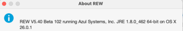

REW measurement should show LFE range only to 120Hz, unless there is a bug somewhere...
Dirac changelog, for version Dirac Live 3.13.2 says this:
When Dirac is handling bass management (BM, BC, ART), the LFE channel will always have a low-pass filter applied at 120 Hz. This is to comply with LFE channel handling requirements and be consistent with the Dirac Live Bass Control (DLBC) behaviour.
@TimoJ If there is something I can check on my end to verify, let me know. Please note this does not at all sound bad/wrong. ART provides a very clear bass and low mid clarity I didn't appreciate until upgrading from DLBC. I am very pleased. No regrets.
