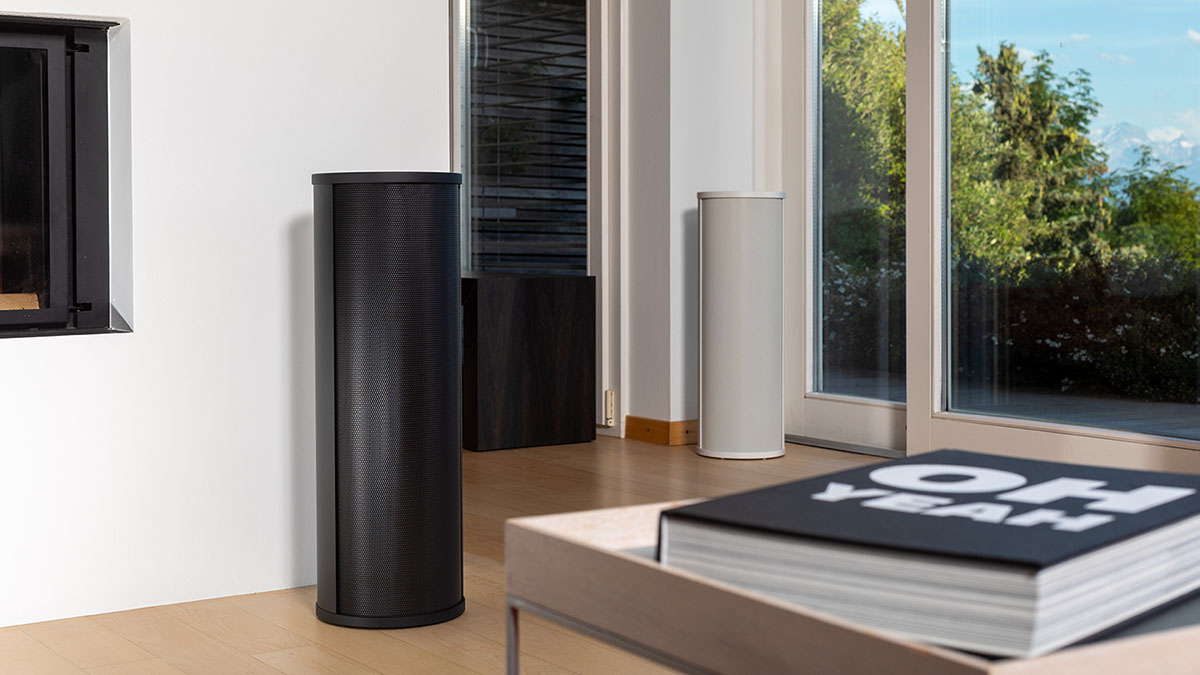

You can cancel the low frequency components to a certain using the Psi Audio active absorbers. You'll need at least two, if not more, depending on the size of your room. https://www.psiaudio.swiss/avaa-c214-active-bass-trap/
Those things are a waste of time. They can't absorb sound, they EMIT sound. It's a bass cancellation scheme. It wouldn't be so bad if it was reasonably priced, but over here they cost AUD$6000 (USD$3900) each. At that price, you are better off with two subwoofers. A friend bought two of those for his massive room (6m x 11m, or 20ft x 36ft) and they did not make any measurable difference whatsoever.
I think you are confusing them with other, earlier devices. The only time they emit sounds is when you mishandle them.
If you own one of these and like it I'm not going to tell you not to like it but they don't seem to do much in objective testing:
If you have measurements with the thing on an off that are different please share.
