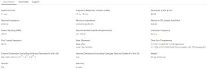

Well, if I check the specifications on the web for my rears, they go down to 47Hz.
If I read my chart using Dirac live (standard) the corrected curve goes down to approx. 27 Hz. (see attached).
So it is a good question if they would be helpful if I buy a new AVR and the ART license... what would you guess? That would be awesome as I dont have much space in my living room for a second sub...

They would for sure be helpful. How much is to be seen. ART seems to roll off speakers with a bit of a cushion, as they note in their literature. Even if your speakers get 50hz contribution rating, that will be a contribution to the overall bass performance.
I am facing the issue of ART being too conservative with rating my bed channel speakers, but have yet to tweak that. I am quite confident in what my speakers can do and have tested that previously, so will try to push for more out of ART. Unless you have the same level of confidence, probably better to let it go.
