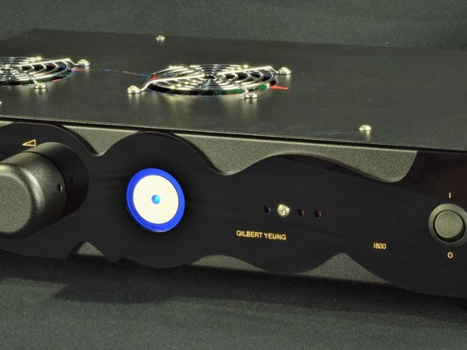

Hello,
I thought I'd ask for thoughts and opinions on the designer of the former Blue Circle company. I'm interested in the idea of a harmonic tone control and this preamp seems like a fun idea. Any thoughts? How's he doing it?
Ah here are some relevant measurements....

I‘ve been to Toronto in late 2023 and gave the C312 an aprox. 2hrs listening and I liked it a lot - very nice sound and a tremendous play factor, BUT no remote for those gain dials at U$ 6300 base price.
I have a decent tube amp and I’d say the C312 preamp was at least as nice plus the benefit to make changes when the source calls for adjustments.
I‘m still considering buying……
