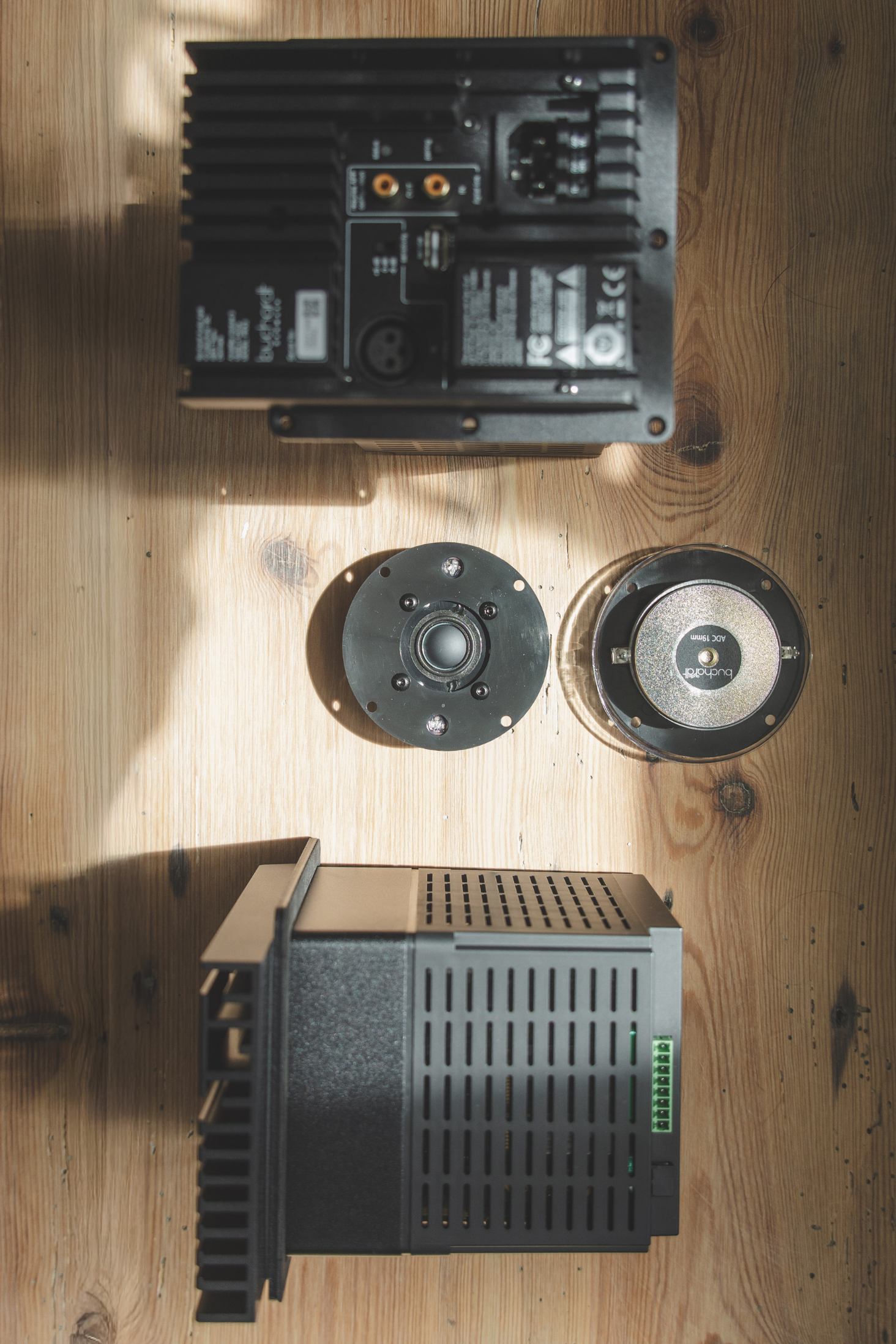

Interestingly enough, while we're debating here whether KEF's decision to do without PEQ and automatic correction is a good one or not, Buchardt has come up with this to improve his active speakers.
Among the improvements, note the new DSP with PEQ and automatic corrections!
Just to be clear, I'd like to point out that the Buchardt Anniversary 10 can be considered a direct competitor to the KEF LS Luxe.
