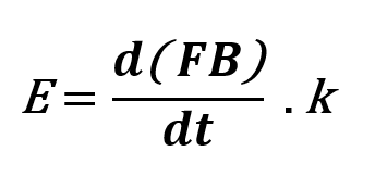

James Clerk Maxwell formalized Faraday's discovery into what is now called Faraday's law which is written like this,
where E is the electromotive force, ΦB is the magnetic flux, and k is a negative constant which also incorporates the number of turns in the coil. The d(x)/dt part just means, the rate of change with time.
So E (the electromotive force, or voltage) generated in the coil relies on three things: the strength of the magnetic flux (ΦB); the speed (velocity) with which the flux changes (d(ΦB)/dt); and the construction of the coil, especially the number of turns of wire in the coil (k).
