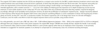

I have a pair of LS3/5A and performed some measurements. There was discussions about them on another forum
One older well respected British fellow had many details including what's in my attachment
A version of LS3/5A outside measurements and inside measurements with grilles on and off at 3 distances.
Subjectively - no bass(can't get past this fact) but had so called "magic"(drivers well integrated exposing recorded detail). There were worse speakers in the early 80's from my experience as far as what was being pushed from local retailers.
