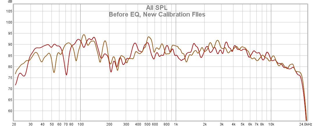

Here is my listening room as of a couple of years ago, without equalization:
Notice the dip between 200 and 300 Hz. That's a room effect. Notice the dip at a little above 1 KHz--that's a small dip in the response of the speakers, as noted in the anechoic testing (this is the "listening window" response as reported by Soundstage from testing in the NRCC anechoic chamber):
This listening window is averaged from these on and off-axis measurements:
On axis,15, and 30 degrees off-axis:
45, 60 and 75 degrees off-axis:
That can be fixed by equalization, as Dr. Toole suggests above. And I can also use EQ to do something about that dip in the mid-bass.
I use a Yamaha YDP2006 digital parametric equalizer, because I'm old-school and prefer real devices over software, especially for speaker and room correction that will be applied to all playback. After EQ:
There are still nulls in one channel at 52 and 90 Hz, and in the other channel at 72 Hz, caused by cancellations in the room. And there's a null next to a spike in the upper hundreds. Those nulls under 100 Hz might get help from properly integrated subs, if I would use them, but frankly none of these narrow nulls distract me in the least. I get more of a change from turning my head or reaching over to get my glass, and that much is true even if I'm sitting on the front row of the mezzanine in a concert hall.
