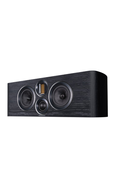

Wharfedale doesn`t offer the bigger 3-way design anymore with the new EVO 5 line. If you can find used EVO 4.C and can fit it with TV wall mounted then consider it!

The Wharfedale 5.2 EVO Bookshelf speaker is three-way, check specs below. The EVO 5 Center speaker is two-way.
