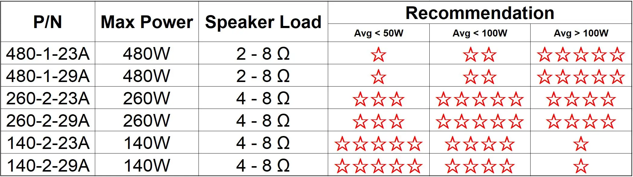

Does anybody know if there will be a 3E 140-2 version to buy?
