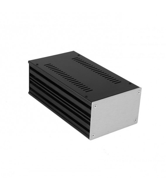

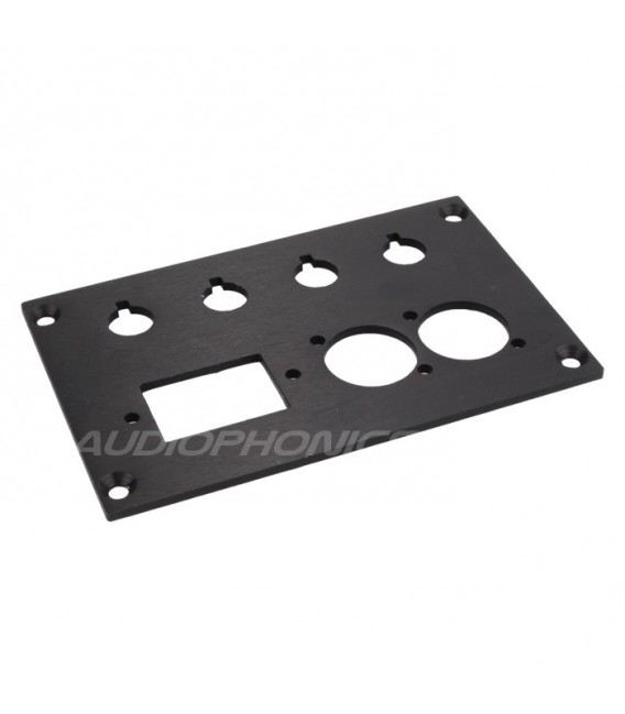

Is there some crtical mass to enquire about a ghent audio case with suitable mounting holes for the board and power supplies?
When I based myself on my first research, I thought of a very simple solution for novice DIYers regarding the case.
In my opinion this solution may work for everyone, check it out anyway (The dimensions should be re-checked) :
For 40€ +13€, you get the GX183 Alu case + rear pre-drilled panel XLR / IEC / Speakers)
Nice find. I'm not keen on drilling the holes but this is a nice workaround!
-think the Dimensions are too small.
SMPS MP-H250S48 is 126 x66 and the 3e audio TPA3255 is 120 x 85 so I make that 246mm long for the 230mm case.
DId I miss something were you stacking or overlapping?
