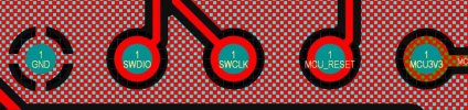

In January 2025, I received two 3E Audio A7 Mono amplifiers from the first batch. They have poor auto-on/off sensitivity, and it's impossible to disable 5 min sleep mode. For a year and a half now, they've been working perfectly in my system with power supplies I built myself.
Recently, I had some free time and decided to update them. I sent an email to 3E Audio, and they told me that I would need a programmer to update the firmware of the STM32 microcontroller, and that I would also need to remove one small SMD resistor on the PCB, which was already mentioned here. Afterwards, they kindly provided a picture of the PCB showing the contact pads for programming the microcontroller, along with the latest firmware.
I purchased a Chinese V2 programmer for $3. To use it, I needed to install a USB driver and the free ST-Link Utility software from the STMicroelectronics website on a Windows PC. The amplifier is equipped with an STM32G030F6P6 microcontroller in TSSOP20 package with 20 pins. I installed 0.1" single-row male pin header (2.54 mm) into the PCB holes to connect the programmer. To update the firmware, the programmer connects to four of the five installed pins. The update went smoothly in a few seconds. Removing the SMD resistor was a bit of a challenge! The components in this part of the board are 0402 size and are quite tightly packed. Removing them required the use of a microscope. I've attached a short video comparing the components with a wooden match head. In return, now I have a fully updated version of the A7 Mono with the ability to disable sleep mode, 20-minute sleep time, and high sensitivity to low music volumes without turning off the amplifier.
Many thanks to @3eaudio for a wonderful product and caring customer service!
Good music and pleasant summer evenings to everyone!
Update: the firmware is universal for the entire range of A5se/A5/A7se/A7 and A7 Mono, as follows from the file name - A5x_A7x.
Impressive! Kudos to you @astamixa for your skills and to @3eaudio for the support they provided.
Thanks, @Dave TR3A ! Life is about learning and discovering new things. And It's exciting, wonderful, and rewarding. ASR Forum is a wonderful place! Thanks a lot to @amirm and many other members, I've learned so much useful information. Kind regards to Ontario region!
It's great that you received the support from the manufacturer and all, but this is 2026, updating a firmware should not be this difficult and that is a design problem to begin with.
