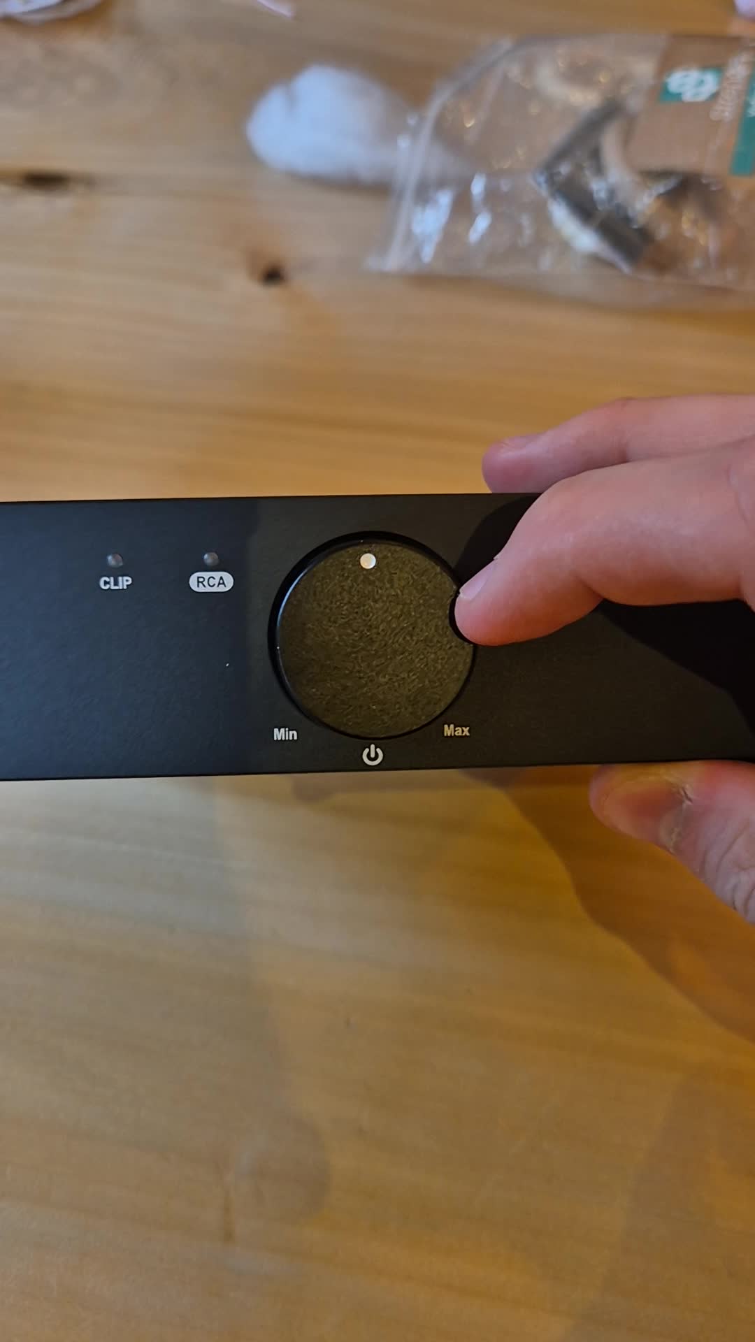

So I just received my amplifier today. I immediately noticed that the volume knob has about 2 mm of free play in it. Is this normal? It feels a little disappointing. I expected a knob without any freeplay .
The feel of the rotation of the knob itself feels solid and not too light.

Does anyone have this as well or should I return this to the seller?

Yes, this is normal. Have fun with your excellent power amp.

It's the same with my PA5 II amp and L50 HPA. As @harkpabst mentioned, it is probably normal.
Thanks both. Much appreciated. Alas, though I won't use this knob that often.
