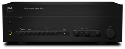

Reason for this question if my NADC370 will fail beyond reparation i considering to replace it with the A7 as one of the alternatives. However i'm still impressed by the thight low reproduction of the NAD at 2 ohm 305 watt not to taking in account it Dynamic output power in these condition at 2ohm we are taking about 846 watt. Will the A7 sound the same or better than the NADC370.?
