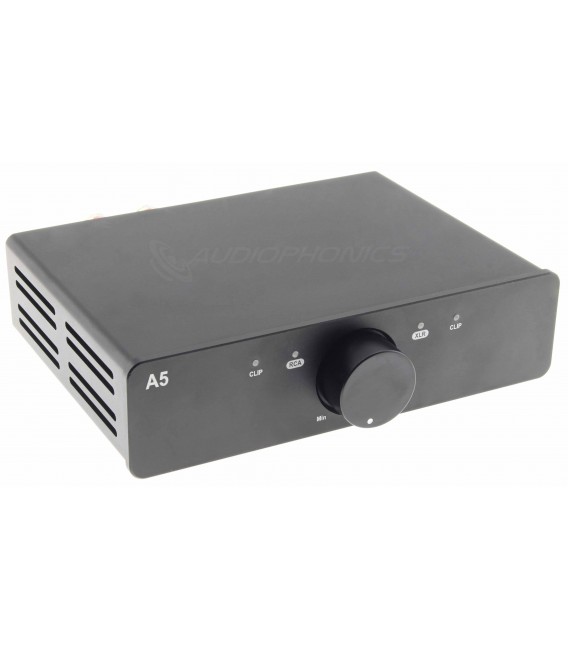

In the review, Amir wrote that the A5 barely got warmer than ambient temperature. In my personal experience it gets quite a bit warmer than that, also when it's not playing music (but still switched on). What are other owner's experiences with the temps?
Hmm my unit it’s quite okay. I wouldn’t call it super hot. Normal temp for an amp.
It doesn't get as hot as e.g. the Fosi V3 Mono, but definitely quite warm, even when sitting idle.
A warm case basically can mean two things: Either heat transfer from the tiny TPA chips is working efficiently or heat is building up inside the case. With the 3e Audio A5 construction (generous vents, TPA3251 chips connected to the top through a big heat spreader) I'm pretty sure it's the former.
Significantly cooler than the V3 Monos for me, the A5 through winter has only got slightly warm. The real test will be in the summer when ambient temperatures for me regularly hit 30+C. But so far temperature for me with the A5 has been a non-issue.
Yes, there is such a thing. Heats up noticeably.
Without an exact measurement of the case temperature, such statements only lead to heat hysteria.
Humans are completely incapable of comparatively estimating temperatures; the differences are around +/- 5-10°C, making them completely useless. Added to that is the difference in ambient temperature.
An infrared/laser temperature measuring device for -50-500°C costs €15-20 and provides accurate measurements. You can also buy a very cheap thermometer with a measuring hole (temperature and humidity) on the back for €2-3. If you place it with its back on the device, it will display the exact housing temperature after about 1 hour.
As a guide, if you can leave your hand on the device for at least 10 seconds without it hurting, it's not too hot.
If the device does get too hot, especially when idle, there may be a defect (this includes a bad thermal connection to the heat sink or case), or an inaudible frequency is being fed into the device, causing it to heat up.
Hysteria? Really? ;)
Yep. And still the measurement result is useless without specifying the ambient temperature (easy to do and to compare) and the placement of the device (not quite as easy) and the load scenario (well defined, but may be hard to reproduce). I'm sure we're in agreement here.
And this is exactly the guide I'm following to distinguish quite warm from hot. :)
During my listening tests (average power probably low in the 1 W to 2 W range, peaks probably 10 to 13 dB higher) the highest temperature I had captured with my cheap infrared thermometer gone was ~42° C at an ambient temperature of ~21° C. The amp was free standing, natural convection only, but placed on top of my Lyngdorf amp used as a pre-amp.
Thanks to your reply, I remembered I actually own a cheap infrared forehead thermometer which is also able to measure the temp of other objects.
When measured at the top center of my A5 I measure around 38°C after an hour of "normal" usage (with amp volume bypassed) at ~22°C ambient temperature. When measured through the ventilation openings at the side I measured around 42°C. This was a lot less then I estimated by touch, which shows how inaccurate my guess was.
Thank you very much for the feedback; this will be a good guide for other users. The temperatures are absolutely within a good and normal range, and there's nothing to worry about at all.
