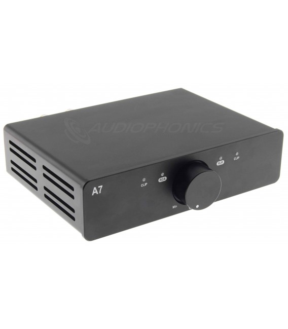

But for me the Auto Trigger and missing 3,5mm headjack Trigger seems a Deal breaker...
There seems to be issues with Auto Off in Low Volume. My KefKF92 has also annoying Auto Off at low volumes. I would prefer a normal Trigger... :/

Did not work well for me. During gaming, it would auto-off on me, and when action happens it takes 2 seconds to turn on, completely ruining horror games. Rain and footsteps in games isn't enough to keep it on.
After some testing, I found that it will not auto-on with any frequencies above 4Khz.
Since there's no way to force the device on (unplugging and plugging power doesn't even work), it's unusable for me and I returned the device.
30 minute auto-off would have worked in this situation.

Does having 12v trigger connected bypass the faulty auto on-off on the a5/a7 that I’ve been hearing about
Faulty?
It’s not faulty, it’s just to a lower level than some of the users need.
I wonder if a [crappy] workaround would be to inject DC on the signal.
Or even worse, run the interconnects alongside the power cord for a space heater, and put the space heater on a timer so that the 60 Hz EMI comes in (at a hopefully inaudible level lol)

It's really unfortunate TBH that 3e removed the 12V trigger... other amp companies have gone back to having a trigger in addition to auto on/off. For the same reasons a few have mentioned here... gaming and movies, where in quiet passages the unit is turning off.
3e should put it back for the next round of models... I think most would be happy to pay another $10 - $20 for this feature.

If the socket for the 12volt trigger is still on the PCB it may be possible just to short out two of the pins to provide a permanent 12 volt trigger signal. This is of course if the functionality is still supported in the MCU software.
Maybe 3e Audio could confirm if this would be an alternative solution although it does of course require the user to open the box which for many users may not be desirable.

Agreed. And if they make it more sensitive they will have complaints from other people about them never turning off, or turning on unexpectedly. There is no sensitivity that is correct for all situations unfortunately, which many other companies have run into when trying to implement automatic power on/off. An adjustable sensitivity should work for most people, but even then some with interference issues may have trouble finding an acceptable sensitivity. Some people need something like the trigger to override the automatic power control.
just share here
actually the components of trigger are not populated yet,so it is hard to do that,also making a hole on the back panel won't be so easy.
we do have a solution by remove 1 resistor to increase the sensitivity by 14dB,RCA down to 400uV and XLR down to 800uV,but this also need some skill of diy
