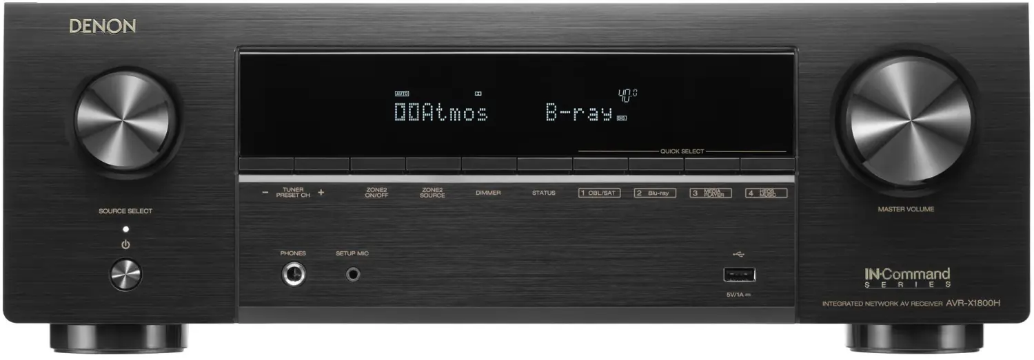

I think it’s a pretty valid question: is it better to go with an AVR setup or something like a Wiim Ultra and A5 combo? I’ve asked this a few times already.
The prices are similar (on black Friday), but with an AVR, you get everything in one box—no external power supply, a built-in HDMI switch, more codecs, and a lot more convenience.
With the stereo combo, which is the route I went, it’s more of a hobbyist’s approach. You get to experiment with different sound profiles, swap out DACs and amps, and chase better measurements. It’s fun, but let’s be real—if you’re a regular user, sticking with a standard AVR just makes more sense.
If you increase the gain even further, you’re in the range of a decent Denon AVR (97 dB SINAD at 5 Watt) —but with lower maximum output, fewer channels, and fewer features.
Where did you get this number?
All I found was this:
S/N Ratio (Line, IHF-A)98 dB
At denon.com I could not find any performance specifications besides power.
Do you have a better source?
If it is correct, that is not SINAD but noise only and it is in relation to FS I suppose and not 5W and A-rated of course.
For 5W and without A filter this would be already quite different and then there is THD.
But the Denon is still an impressive peace of gear for the price. Just not what I am interested in.
SNR of the A5 is ≈120dB and that is without A-rating.
