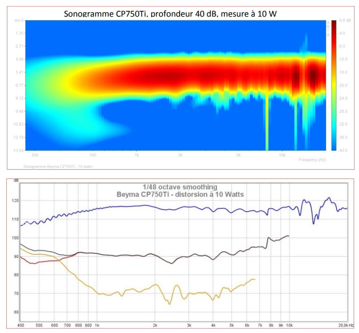

The point of these horns family is to be full-range and load in a rectangular shape (there is a reasons why it's not very adapted to round horn).
Ideally, use a 1.4" compression driver with a professional 15" woofer (e.g., 18Sound 15NTLW3500), and cross over at the frequency where the directivity matches, around 750 Hz, as JBL does in modern designs, not a problem even for old ones as JBL 2226H.
Good capacities mid-range for compression driver is not so hard nowadays but if you want a not to expensive and very-good components, it's the 18Sound 1460 (no need of "N" diapragm). You can also use a Faital HF1440 and his annular diaphragm but not in night club with high SPL, annular diaphragm have less radiating surface, it's one of the reasons there is two of them in the D2, annular diaphragms have H2 rising faster in the low end because H2 is mainly related to excursion (and also compliance geometry).
But annular diaphragms have very low H3, due to the “donut” diaphragm shape and the effect of this shape on breakup.

Not personally but a friend yes :
Temporal problem below 10khz and H3 (yellow) rise bellow 1khz, it's not very good, avoid this compression (1.5 or 2" version, it's the same), same for DE250 and other "forum" compression, best one are in fact:
