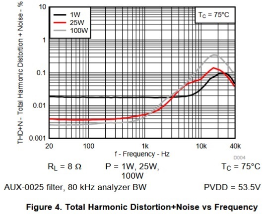

TI is a serious company. It conducted these tests itself. This picture is from the datasheet for the TPA3255. It also contains measurements of the THD from a frequency with an operating band of up to 80 kHz and standard ones up to 20 kHz. Here you can see that the TND grows with frequency. It grows strongly for a device that claims to be high-quality. As a computer amplifier, this is normal. As a basis for a high-quality system, in my opinion, it is not normal. But I do not forbid anyone who likes this amplifier to buy it :).

The THD+N (Sinad) jump in the high frequency is so obvious that it is a pass.
