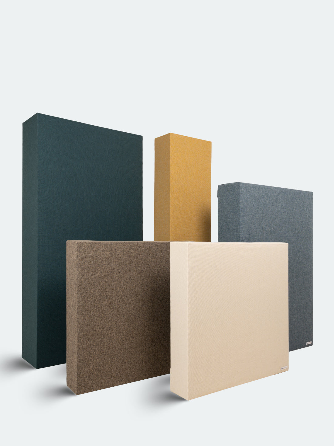

check these guys out. seriously good results. their corner traps, and separate bass wall connection traps are amazing. no joke. best part is you can order in large roll out. i used t pin, sewing style pins and went into the sheet rock at a 45 degree angle and they hold huge roll outs on the ceiling, walls and everything, no tape or glue. very easy cleanup and removal if you need to move them or remove them.
Dedicate a portion of the budget to some room treatments that could also function as pieces of art ? Not too many pieces so that they won't become a burden when you decide to move. I think that you cannot escape SBIR effects with DSP/PEQ or by simply buying an expensive speaker.
Two pieces for primary reflection points.
Two pieces for secondary reflection points.
Thick absorption behind the listening space.

But as other said above - add some room treatment. Start with acoustic panels. Generally the more you add (up to a point) - the better. Here is a good brand https://www.gikacoustics.com/product-category/acoustic-art-panels/
