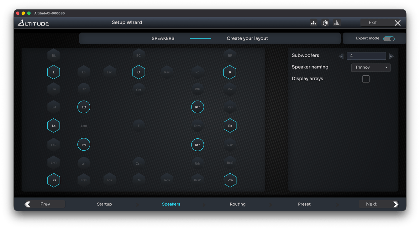

Thinking of an AltitudeCI.
It's future proof anyway.

Looks like Trinnov would have you covered for that.
https://kb.trinnov.com/en/knowledge-base/speaker-declaration
In their channel naming convention it would be:
L, R
C, Cs
Lw, Rw
Ls, Rs
Ls2, Rs2
Lrs, Rrs
Now let's look at the angles in the diagram I posted above. If we take the middle of each range...
Fronts: 26°
Front Wides: 60°
Surrounds: 100°
Surround 1: 122°
Surround Back: 142.5°
So between Surrounds and Surround 1s there are 22° and between Surround 1s and Surround backs there are 20.5°.
As the room is 11 feet wide (3.3m) if the speakers are installed in-wall then the distances (along the wall) between speaker centres would be:
Surround to Surround 1 = 74 cm
Surround 1 to Surround Back = 1m 12cm
(Would just meet @Oddball 's 70cm rule)
If the speaker front baffles are all 20cm from the wall, it would get a bit tight between surround and surround 1.
Surround to Surround 1 = 65 cm
Surround 1 to Surround Back = 98cm
Note that the above does not take into account the width of the front baffle. If that is 20cm then you would only have a gap of ~45cm between Surround and Surround 1 in the second calculation.
If you bring the surround backs closer to the listening position (as is normally done) then the Surround 1 to Surround Back gap would also become smaller.
