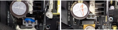

I used the 6.3a. On the plate amp under the fuse there is a label written:
120V = T6.3L
230V = T3.15L
M
Image on the left is 120v with jumper installed, blue wire.
Image on right is what the 240v looks like jumper missing.
What the YouTube...
M
Success: I've added the jumper cable and changed the fuse.
I used these from Amazon. I selected these because I could get them next...
