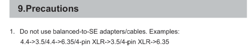

Exactly as @Ahmonge says: balanced headphones on single-ended amplifiers/outputs are no problem, but single-ended headphones on balanced...
B
The rule to follow when connecting an amplifier to headphones is: ‘You can use an adapter to connect a single-ended output from the...
B
I might be misunderstanding the manual, but I would have imagined the instructions to say something like don't use 3.5->4.4 adapter...
B
Isn't something like this safe? Maybe they just don't want you using faulty ones?
Wondering because my 4.4 to xlr adapter (fiio) is...
